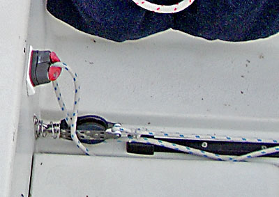

The aspect of the mainsheet system I am most happy about is the cross-haul arrangement. This is a continuous line running from the car to a block at the coaming, up the cockpit side to a cam-cleat. This allows you to sit on the rail and adjust the car; as it's continuous, you can pull the leeward side out of the cleat without moving.
The point that sets it apart is the use of Ratchamatic blocks at the coaming. I feared a child getting him or her self on the wrong side of an unsecured car during a tack and getting walloped (in practice, adults are more likely to do this; children are too quick). With the Ratchamatics, any load locks the sheave, so the line drags slowly through the block and the car moves at a controlled pace down to the leeward side.

David, do you have a picture of your car arrangement? I definitely like the sound of what you've rigged. It would be another great tweak for singlehanding..

All I have, which is a piece of a picture meant to illustrate something else, is the arrangement at the coaming. This shows the Ratchamatic block, the cam-cleat and the blue flecked control line, which leads simply from the bottom of the Ratchamatic to a single block on the car. From the top of the cam-cleat, the control line leads to the top of the other cam-cleat. The line is continuous, so you can leave it cleated until the tack is complete. A tug on the line then pulls it out of the leeward cleat.
